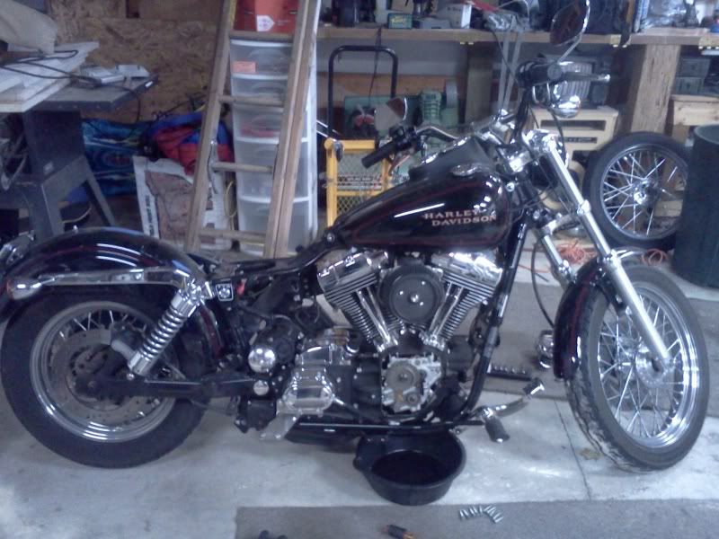

The roads are Icy so I'm tearing stuff apart.. I desperately need a Manuel and will probably buy one in the next few days.
I am currently modding my 02' by replacing my 39mm narrow glide front end and putting on a newer style 06' 49mm front forks/trees/wheel, I would like to powder coat the trees and lower legs but need more cash and I still need a headlight and some new stem bearings and I will get started on the install.
I have 11K miles so I check'd my Cam shoes just last night and They are both worn. The rear one is worn by at least a third.. I am so glad I checked.. Now I need to buy the screaming eagle cam plate upgrade kit I guess..
How do I check run-out for installing cam gears? is that in the manuel?
I will also be looking into doing a big bore kit, not sure which one or to just have my Jugs bored out.
Any advice is appreciated.. Thanks
would also like following mods:
C&C fastback seat
west coast MX-T bars 10"
maybe a short flyscreen??
Performance machine grips
Here is my bike now

Nice looking ride. I will be installing the hydraulic tensioner upgrade soon too. I bought the Andrews complete kit and selected the 21N cams. Will prolly do the job next month, more or less. Still having occasional warm weather to ride in, so.....gotta wait.
Considering a BB kit too. Luckily there is a place nearby that has them, but I will first see what the new cams do
Have fun!
