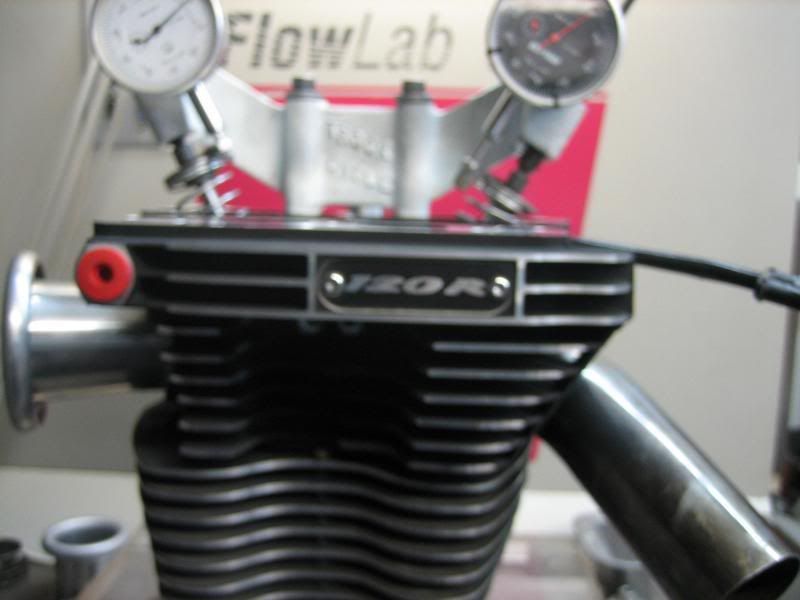

I have received several request as to what Eric's and my heads ended up flowing.
this is what I got from WFO Larry. he did the porting ,guides, and flowed them.

Stroker,
Just out of curiosity, using the same set up in your pictures, what did the heads flow while they were stock? Just trying to get a little bit of Flow comparison between the MVA and R&R heads.

What did the exhaust side flow?

Hey,
Any numbers available in the .300"-.500" range?

stock on the same bench
IN 305 EX 220
after IN 330 EX 240
Larry does the EX @ 10 usually. but I think this is what he told me the EX did @ 28
I haven't really used these heads to there fullest. exhaust/cams/compression. Eric's pulled a 140 tq. but we really bandaged them with the t man cams. Eric's 662-1 pulls the best followed by the 662-2. but both need more compression and cams that will work with these heads to use there potential.
but they do pretty well out of the box in the crate motor at 10.3 .

I am wondering the same. I like to see .100-.650 , and cfs. you also need the inches they are pulling to compare to others. I know one guy that only pulls 15 or so. he claims pulling more shows numbers only to make sales.

flow numbers are like dyno numbers. they are tools. use the same tool and compare before and after,. all along learning.
but hey I like seeing data as well.:)
Larry mentioned he likes to flow the exhaust @ 10 so he can hear it.

I tend to agree, but with experience one can compare different numbers from different tools. provided they have the proper data.
