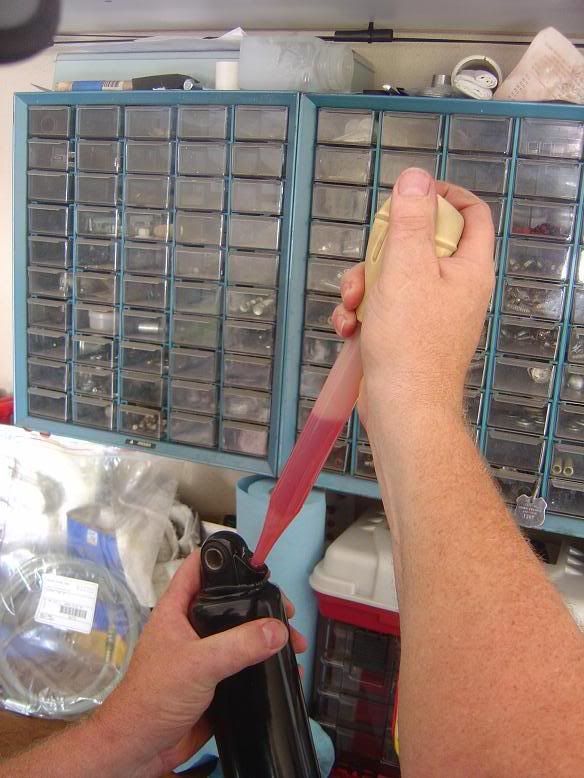

We started with his bike since he had 1 side of exhaust and mine had 2...1 shock would be cooler then the other on his bike...We removed the shocks and when they were on the bench we removed the quick release connection for the air line...Now the Rocking began with the shock in hand and this proved to be as slow as I rememebered it the last time I did it...(There has to be a faster more productive method)...There was if I had the fittings so I dug around while he was rocking the shock drainning the fluid slowwwly...Bingo, I found a 1/8" mpt fitting with a barb that would now attach to my mighty vac line...
Oh man, was this to prove to be a great idea...just sucked the fluid right out like nobodys buissness...
(enclosed a pic...)
After the fluid was evactated we proceed to install the new fluid in the shocks with a turkey baster...worked last time and contuned to work this time...
