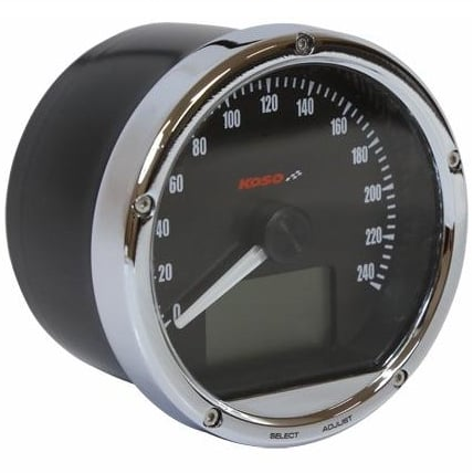

I see.... I do not remember oem measurements, but maybe you check out the 85mm version with chrome ring...
This one is 30mm bigger than mine, 85 mm no bells and whistles
Maybe a better fit to the oem mounts.
240 mph is somewhat over the top, but you could still add bigger engine and brakes !
There's a 140mph version too 140mph Koso
Signal option, if you do not like the magnet on wheel or brake rotor :
