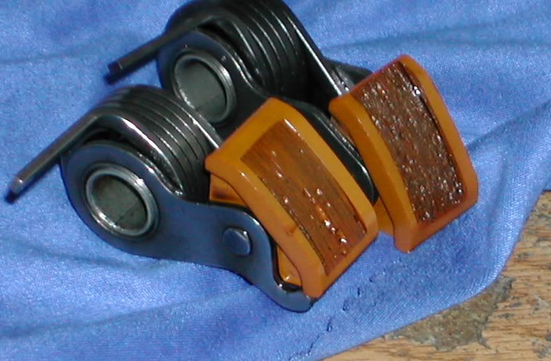

There were a couple of people asking about my tensioner wear when I did my recent build. Thought I'd post a pic since it's always a subject of interest here. So I dug em out and here they are at 27,000 miles. I replaced em when I did my build but will put gear cams in no later than next winter. I'll decide if this is the build I wanna keep over the upcoming riding season and if it is, I'll just replace my 37b's with 37g's.

They look pretty good to me for that mileage.
I would say the recommended check of 20K looks like a good one.

They look a little better then mine did at 26000. Glad they are gone :)

I agree LAF, I was happy to see they weren't any worse than that. Gotta remember, I live in a very mild climate so my bike rarely and I mean rarely (never?)gets really hot. I for one think that heat has a real affect on that plastic, just my opinion not based on anything in particular. I would definately say check em at 20k.

On my 2001 RKC, they were almost gone completely at 19K miles. I replaced them and the cam (with a 37b) and rode the bike another 20K until last fall when the bike succumbed to my desire for an 06 Ultra with some extra motor work. The dealer was surprised when he found out the bike only had 19K on it and they looked like they did..
