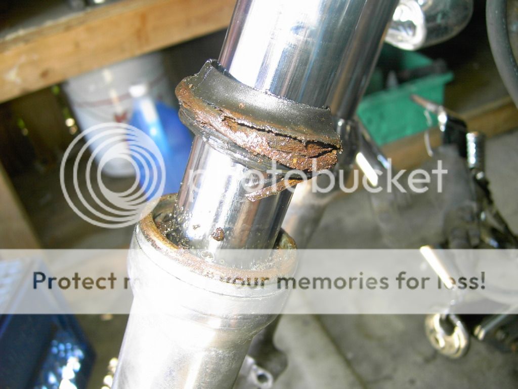

Here is mine with it messy. Mine was gouged by some rust...Yeah, I live at the beach and don't have a garage...
I was riding with friends and I was in the back. We stopped for a quick break, and I told the other guys...Dude, someones got an oil leak, once in a while I can smell it. Everyone checked their bikes and they all said it wasn't them. As I was getting on my bike I saw oil everywhere.

The chrome caps hide old nasty stuff.
Something must have run down the fork tube years ago eat up the dust cover.

My guess would be moisture as in water as in downpour over a period of time.
