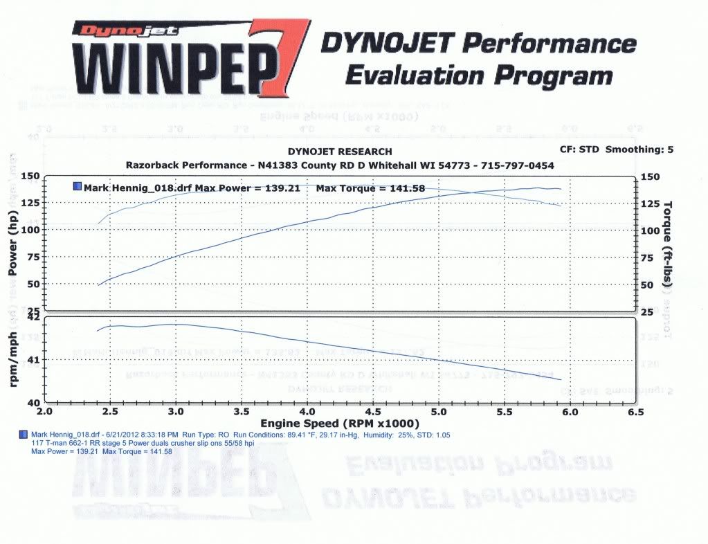

Originally Posted by BVBOB View Post
Why wait? this was on a 117, can only imagine the 120 will do better.
Compression ratio on that one ?
