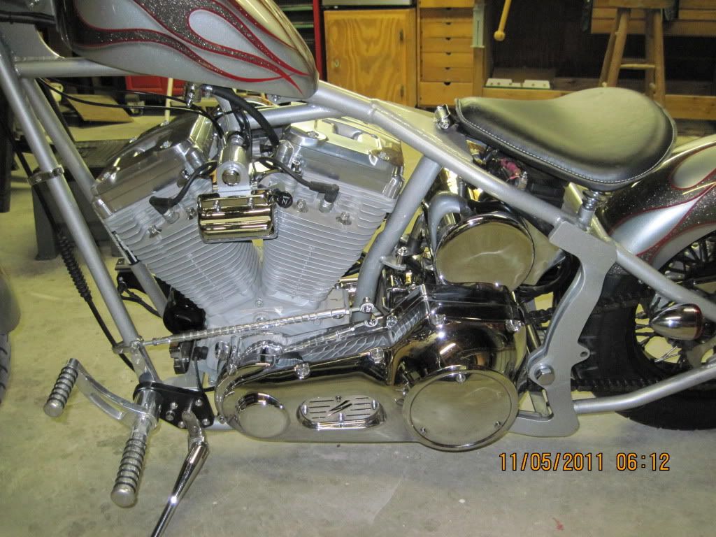

Picked up a Evo bobber a couple of months ago, been tweakin it some. It had a Ultima solo seat on it- it was ok but had a couple of problems. First of all the seat was too far back on the frame, I had to reach for the bars. It needed an inch or two of forward adjustment, but there wasn't any slot left in the seat bracket.
Additionally, the seat bracket itself was a flimsy POS, it didn't take too well to 220 lbs bouncing around on it.

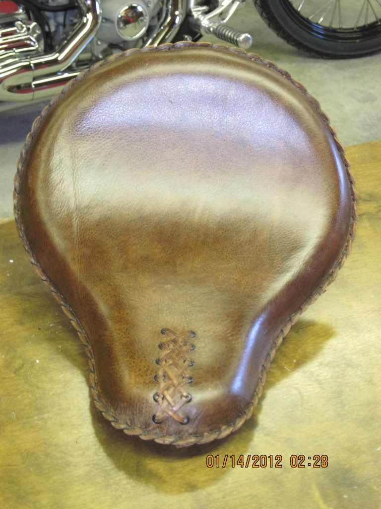

And, I wanted to mount this LaRosa seat-
The LaRosa seat came with a bracket but it still kept the seat too far back. I searched for a bracket but couldn't come up with anything that would fit- the LaRosa seat pan is curved and I really wanted to move the seat forward. Wound up buying a tow hook from good ole Harbor Freight. I had a coupon and it cost me 8 bucks, courtesy of China. After some bandsaw work, a couple of rounds on the drill press, plenty of filing, and a little bending I had a start:
