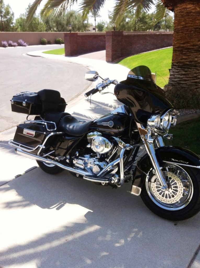

I'm running a Dead Center Fairing on my '06....Love it!!
[IMG][/IMG]
