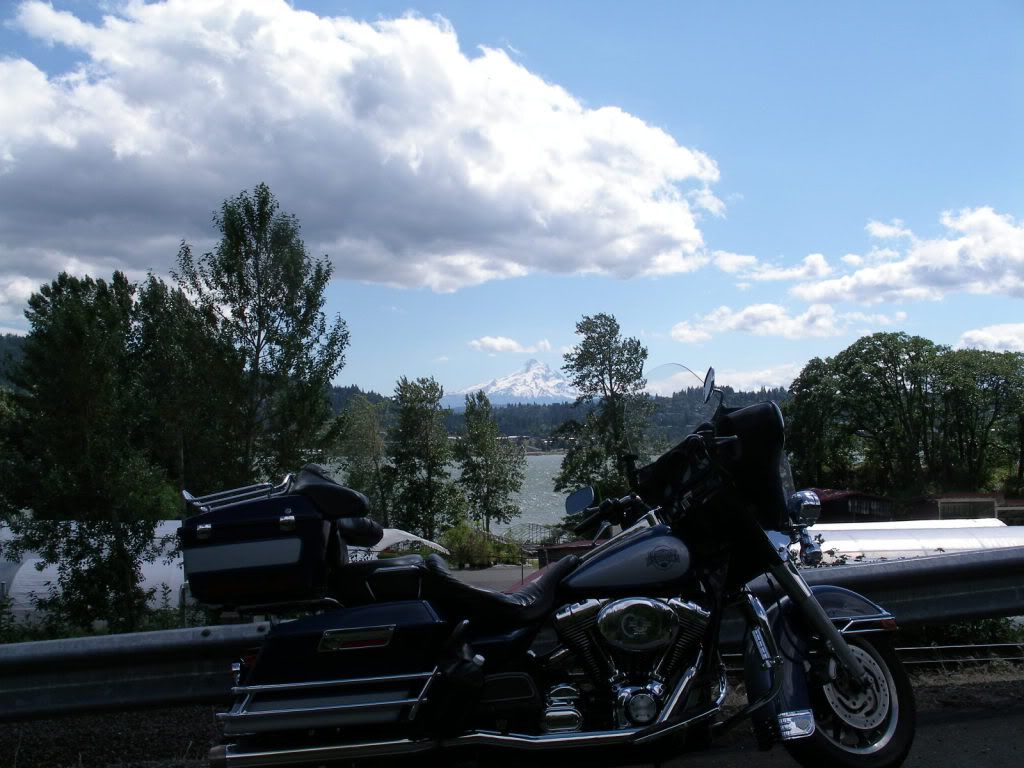

Well looks like you've been covered on your questions,love my 2000 (carbed not EFI) and she's rolled over 170,000 miles so far,great bikes.

Any more pics of your Ultra, just curious how they look after 170k miles... How has maintenance been, oil and tires..??
