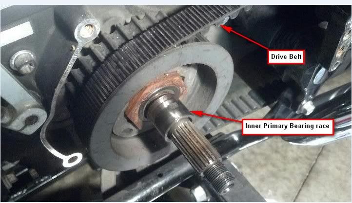

Not to but tell me again how the wheel moving doesn't turn the inner primary bearing.[IMG][/IMG]
You are looking at TWO shafts in that pic...the long one is the mainshaft, which passes right through the center of the short shaft that the pulley is mounted on.
With the transmission in neutral, you can grab that mainshaft (the long one) with your hand and rotate it, and the pulley will not move.
They are SEPARATE shafts.
Dan89FLSTC is offline   Reply With Quote

Originally Posted by Dan89FLSTC View Post
Gearset pics...hope this works right....
From left to right:
Assembled gearset
Gearset with Main Drive Gear removed from Mainshaft.
Main drive gear (the splined part is where the belt pulley mounts, you can also see the threads for the pulley nut at the end of the splines. The big gear part is inside the transmission)
Opening in main drive gear where the mainshaft passes through.
The crud on the gears is a mixture of Redline Heavy Shockproof and styrofoam packing material (a mess).
Makes perfect sense now, thanks for clearing that up!, What were they using in the tranny, please explain the chunks??
