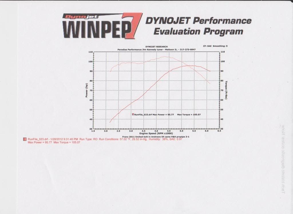

you didnt tune it.
that just shows you a tuning device has to be used to tune the bike.
on a stage 1 such as yours. I see 10/10 increase (at least) when they are tuned vs canned map. and no the sensors are not magic and just dial the bike in.
ok just sent the same thing to durwood so he could show someone.
blue is stock ecm the 2-1 pipe was installed
the red is the stock ecm running the motor with the pipe and andrews 54 cams.
the green is with a canned map that came from durwoods bike,that was tuned with 204 cams. (so it is better than any canned map) ,and it still wasent WOS.
after tuning the bike
I would agree with that, I saw a 15/15 increase after tuning over the canned map.
